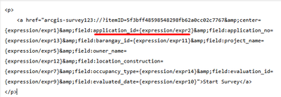

Hello. We are trying to pass some fields coming from the related table of a point accessed in Field Maps to several questions/fields in the Survey123 mobile app. First, we created several attribute expressions in the Map Viewer to call these fields (see photo below for an example).
We then attached these expressions to the custom URL.
The problem we are encountering now is that there are inconsistencies in terms of the fields that are being auto populated when opened in Survey123 mobile app. Some fields are auto populated, some are not. We also tried opening them in the Survey123 desktop app by clicking the Start Survey directly from the Map Viewer, but the auto population seems to be working fine.
