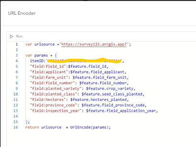

Got it to work! 😁
The URL encoder is the solution.
Thanks a LOT for your help!
(Here is a little how-to for anyone coming to this thread in the future)

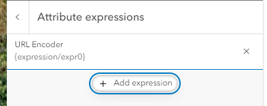

Create an attribute expression:
Put the code in with the encoder:
and finally hyperlink it to the attribute expression
Ken

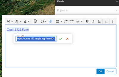

I'm passing it through an hyperlink in a text in the pop-up.  Not sure if/how I can use UrlEncode.
This is the link URL I've created for it:
https://survey123.arcgis.app?itemID=36ff9e8c13e042a58cfce4ad87f55d19&field:Field_ID={field_id}&field...
I've never used UrlEncode, not sure how to use it.  I tried putting the whole thing, shown on the help page, in the Link URL, didn't worked... (I don't think it can handle variable...)
Thanks for your help.
Ken

KenBouchard
Got it to work! 😁
Ken

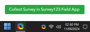

Then, take note of the expression number of the url. In a new text box in the popup I added the following HTML (feel free to reuse):
<div style="padding: 10px;">
    <a href="{expression/expr999}" target="_blank"
    style="display: inline-block; padding: 0.5em 1em; font-family: Avenir Next, sans-serif; font-size: 1em; color: white; background-color: #28a745; text-decoration: none; border-radius: 0.25em;">
        Collect Survey in Survey123 Field App
    </a>
</div>
