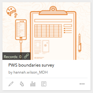

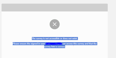

I'm trying to access a survey that I created and published last week, but I'm getting the message "The survey is not accessible or does not exist. Please ensure the signed in user can access this survey and that the survey link is correct." This issue started immediately after publishing - we haven't sent out the survey or collected any data.
The link is correct (I'm coming directly from the "my surveys" page) and I don't see why the creator of the survey wouldn't be able to access it.
The same issue is described in a post from earlier this year (https://community.esri.com/t5/arcgis-survey123-questions/newly-created-survey-quot-is-not-accessible... but the recommended fixes in that thread didn't solve my issue (my survey hasn't been moved to a different folder).

So it tries to load then logs out right away? Like its crashing?  That could be a reserved word or code it does not like.  Can you post the form?
HannahWilson2
Yep, it loads for a fraction of a second and then logs out/gives me that error message.
