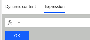

That is likely a bug in Power Automate (happens often).
The workaround for when an item is missing from Dynamic Content is: Go to Expression tab > type "=" > go back to "Dynamic Content" > delete the "=" > scroll through the list and locate the missing item.
