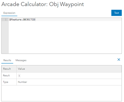

By creating an objectid field with a null field type, I was able to publish the form without getting any errors. And any calculations I use on objid_waypoint shows up in the Sent folder in the field app.
The problem is that the objid_waypoint is blank in the Survey123 online database. The only way to get the calculations is to recalculate it on the edit mode on the data tab, that's how I got the 1 and 2 values to show up.
But recalculating all submissions online using the edit mode will take a long time. Is there a way to recalculate all submissions? I just need to recalculate the one objid_waypoint field.

If you just need to update the objid_waypoint field you can field calculate it using an Arcade function.
If you have subsequent calculations based on the objid_waypoint field they will need to be updated in Survey123 by editing the record.

Thanks @ZacharySutherby, I do need the field crew to be able to see the objid_waypoint in the field app. So would the best way be to include the calculations in the XLSForm so that it'll show up in the Sent folder. And to bulk calculate the objid_waypoint in AGOL using arcade?
