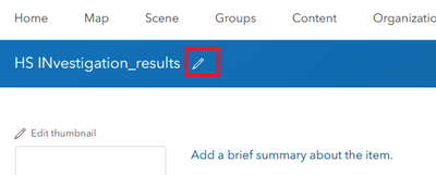

If, for some reason, your Portal name matches this weird name, you can locate the item in Portal and configure the name there (the example below is the same item as my first example, just viewed from a different angle).
If you want to locate this item (e.g., survey123_fcaaaaaaafa_results) in your Portal, search for the Item ID only (e.g., fcaaaaaaafa).
