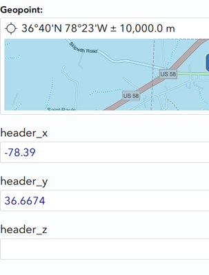

At the end of their blog post, they suggest the same thing I was going to: Could you not use pulldata() on a single geopoint to pull out x, y, and z. You could dump them into a text field for viewing/editing.
