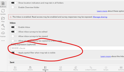

Follow-up. I tested it with one of our warehouse guys on their tablet and worked perfectly. Only thing I am stuck on is once all users are complete with their entries, how is it removed from the Inbox? OR does it remain there?
I am working on a Power Automate Flow and want somehow to remove it from the inbox once completed so other users/supervisors don't think it's incomplete.

I think this will work for that.  Base it on a question that is populated in the second part.
https://doc.arcgis.com/en/survey123/desktop/create-surveys/prepareforediting.htm
