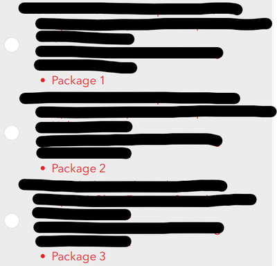

The next question is a select_one question that populates from my Internet_Packages list with package options 1-9 based on the response from hidden Q1
I'd like for packages 10 and 11 from the same list to be added as options to this select_one question if the response from hidden question 2 is = XGS. If the response is null, then I'd like only packages 1, 2, and 3 to be selectable. Please let me know if there needs to be any more clarification. Thanks again!
