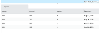

Here is my data table on Data page where to use feature report in Survey123 website.
What I have been trying to do is to : sum up pump1 when station value is 2.(I think this is similar to your request and this request)
Here is my syntax in feature report template:
${#Form_14 | stats:”sum, pump1,pump1_sum”:”station”:”station=2"}
${pump1_sum}
and I got right result from the above syntax, which is 300.
