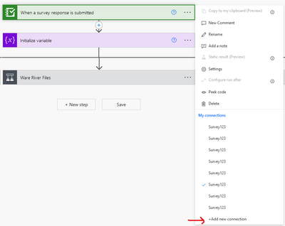

No - I have never had issues in an existing webhook when I was creating a new one. What you will end up with, eventually, is a list that looks like this as you'll need to add a new connection each time a new webhook is built. It's a bit annoying, but now I just know that if I'm building a new webhook I just need to re-establish a connection to my AGOL account (second image).
Erica

You'd probably just open the Flow, locate the connector, click the ... on the right of the card and select "Add New Connection". I don't see a benefit to doing this with existing Flows. Once you save, users will need to re-download the Survey123 form in order for the webhook to work (if you are using the Survey123 connector).
