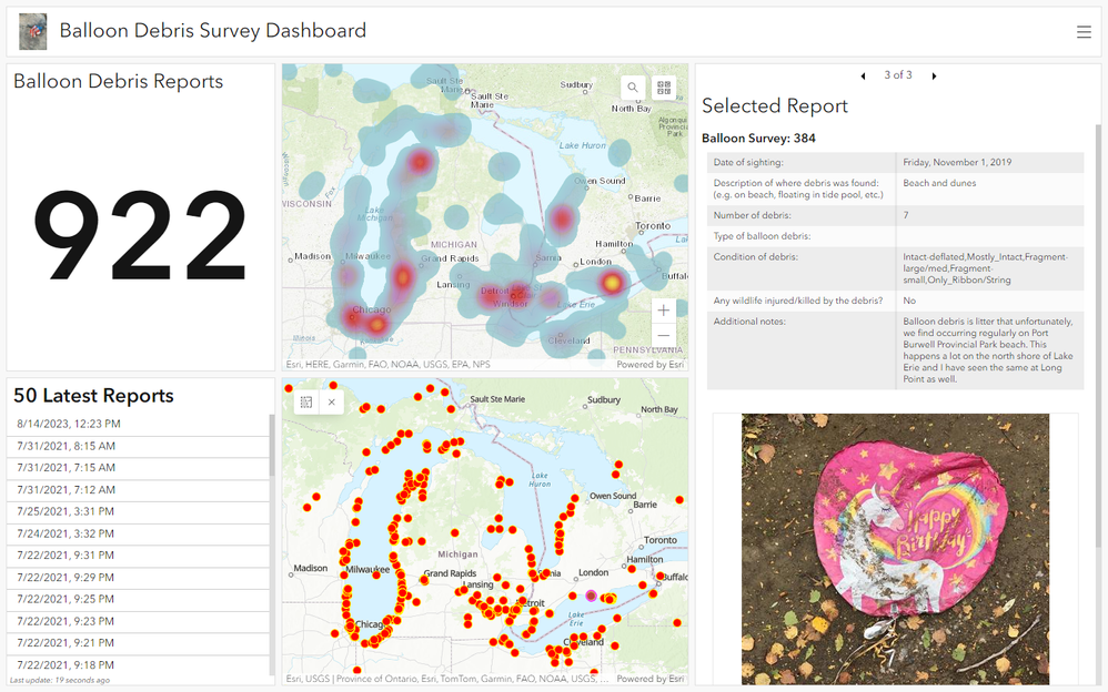

Below is a visual example from a student project on tracking balloon debris in the Great Lakes region. A survey with 922 records when it ended. By selecting points on the middle-bottom map a user drives what is displayed on the right:

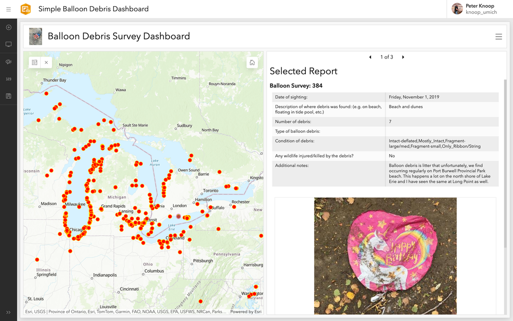

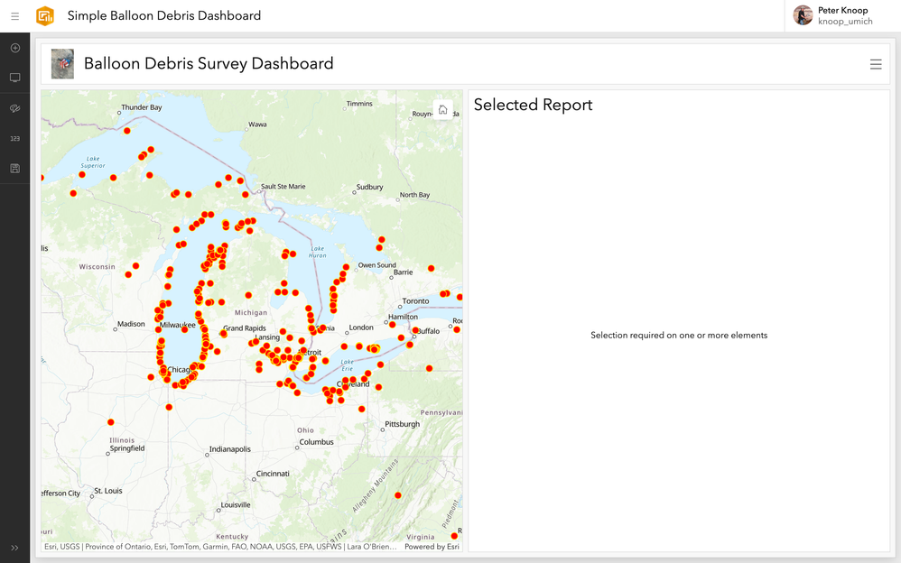

@JenMcRuer here's a very basic example dashboard, with a Map element on the left and a Details element on the right, and both are using the same feature layer as their data source:

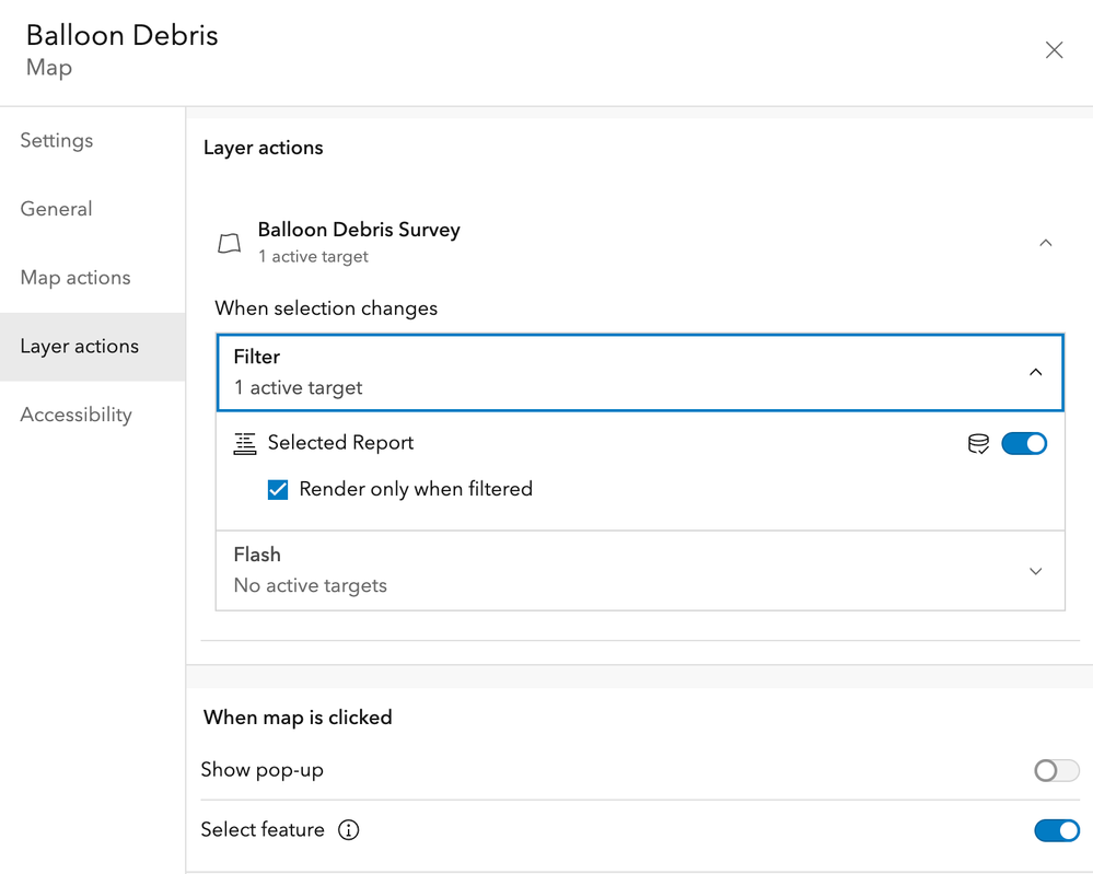

Under the Map's settings, for Layer actions, enable filtering of the Detail element (Selected Report) and check the box for "Render only when filtered." The former filters the data source feeding Selected Report to the current selection in the map, while the latter ensures Selected Report displays blank (as above) if nothing is selected on the map.
Also above, under "When map is clicked", turn off "Show pop-up", so that when a user clicks on a point on the map, the web map's pop up (if it has one) is not displayed. And, turn on "Select feature", so that the feature(s) clicked on in the map become selected, and the actions under "When selection changes" are triggered, displaying the selection's information in the Selected Report:
