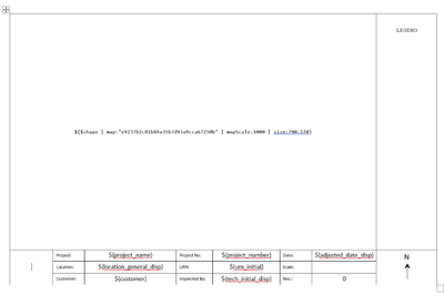

I currently have this on my report template:
${$shape | map:"e9237b2c81b84a35b7d93a9cca67250b" | mapScale:1000 | size:790:570}
my whole template shown below:
The issue could be something to do with the ${shape} bit?

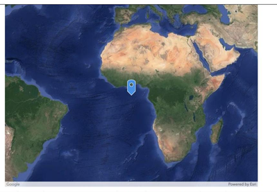

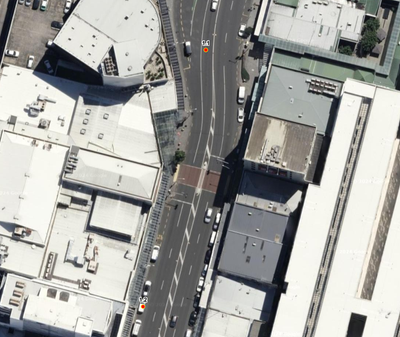

@abureaux below is an example of what i mean. In this situation I opened the survey on my computer which does not have location enabled, it therefore defaults the parent layer location to somewhere off the coast of africa, im guessing this is 0,0.
The geopoints in the repeats I selected manually on the map in the survey. I have a script which i run once the survey is submitted which removes all previous layers from the map, then readds only the repeat (child) layer back onto the map which contains the repeat geopoint questions. The first image is the generated site plan which as you can see, shows the 0,0 location of where the survey was opened, and the second image shows the geopoints which I am trying to get the map to zoom to instead.

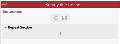

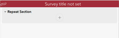

Going back to my "push-to-locate" suggestion, if you make your site location "push-to-locate", and then tie the required column to a field operation like taking samples, that should work out better.
Example:
Default State:
Taking samples:
If you want to take it one step further, make use of the body::esri:visible column:
Either option should help guide users into only taking the site location while on site.

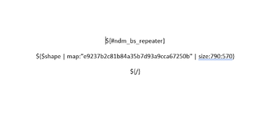

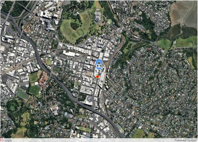

Ok I actually think i've sorted it, i needed to include the map reference in a repat:
It still is zoomed out quite a lot more than is needed though:
next step is to remove the blue marker. Any ideas on how to do that?

I believe that blue marker is your "point" for that geopoint question. Can't remove that.
Okay, so you have a geopoint within a repeat in your survey, and you want all of those points to be printed on a single map within a Feature Report. That should be supported. More details here.
This is probably what you are looking for:
This can also be used to display all points within a repeat:
${repeat1.repeatLocation | where:"inspectionId=123 !important" | size:400:300}
