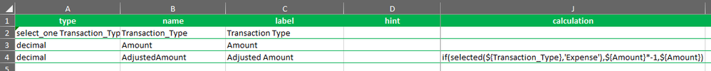

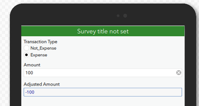

MicZatorsky_AEC
One solution is to use a second, read-only field.  Working XLSX attached.
HenryPittman
Thanks so much I knew it was something simple. It didn't like the circular nature of trying to do the calculation in the same filed that the data was enter just wouldn't work. I ended up using it in a calculate question type to hide that from the user and all is well.
