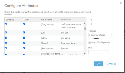

Also, Make sure about the format of the decimal to set it to the maximum.
