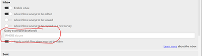

Sounds like you might want to put a where clause on there, instead of tackling it in the instance name.
 resolution_status_latest<>'resolved'
https://doc.arcgis.com/en/survey123/desktop/create-surveys/prepareforediting.htm#ESRI_SECTION1_635E8...

hmm I don't use this too much, maybe try this:
where=resolution_status_latest<>'resolved'
https://developers.arcgis.com/rest/services-reference/enterprise/query-feature-service/#sql-92-where...clause
Not sure whats going on,  I can't get it to work with '<>' or '!=' but it works with'='
So you could try the opposite, and set it to show when it equals  resolution_status_latest = 'not resolved'
Neal_t_k
Or you could set it up so that field is NULL until it is 'resolved' and then for your query: resolution_status_latest IS NULL
You could set a hidden helper field to: if(indexed-repeat(${resolution_status_label},${resolution_steps},${resolution_count}),'resolved','resolved','')
The 'is null' work for me in my test

One more thing to try:  How about instead of =, use "NOT IN" or "IN"
so something like
resolution_status_latest NOT IN ('resolved')
or conversely
resolution_status_latest  IN ('othStatus1', 'othStatus2',...)
