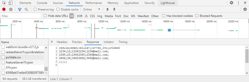

I configured the pulldata csv in my survey and I made the survey public so everyone can access it with a link. But I need the data in the CSV to be private, given that it is confidential.
When I open the developer tools and I open the link of my survey, I see that the CSV file is transmitted from the portal to the browser, and then, everyone can have access to this information.
What can I do in order to be able to use the pull data capability while maintaining the CSV file private?

Hi Eduardo,
I believe I addressed this in the pulldata blog comment you posted - the form and all resources used by the form (images, CSV files) need to have the same sharing in order for the form to function.
