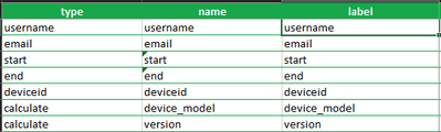

  • More of an information piece than an issue. You can remove the label for all calculate fields and system fields (see below). I wanted to mention this because it isn't apparently obvious, and the new Analyze Survey button doesn't even pick it up.
