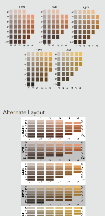

It seems like an image-map-based question would be the key to minimizing taps. I've made a couple prototypes with this method (see below). There are so many soil Munsell book pages to work with that cramming them all onto one svg, makes the individual color values so tiny, they are tough to read and/or tap.

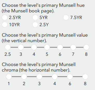

Instead, I've fallen back to using the non-graphic radio buttons to select the values(see below), but that requires more taps and I don't have the coding chops to make sure that a user doesn't inadvertently enter a value that's incompatible with the soil books (e.g. "10YR 2.5/1" when there is no "2.5" value in the 10YR hue).
I thought that maybe I could have several image-maps, one for each soil book page, that could be made visible depending on the hue selected. Then maybe have a text field that concatenates all of the pages' values together (e.g. ${RecordedMunsell}= ${25YMunsell}+${10YRMunsell}+${75YRMunsell}+etc.). Assuming that only one Munsell sheet graphic would be visible, the rest of the Munsell sheet values would be "", so it would just record the selected munsell sheet value. But maybe that's over-complicated.
