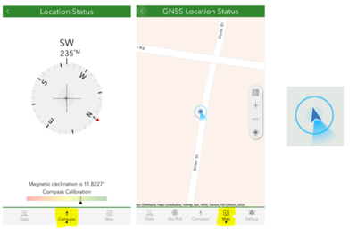

They have a compass display thing coming in 3.13.  You can check it out in the Early Adopter program.
This way it is live time vs a static field.  Hope that helps

Thanks! I have joined the early adopter program and am testing the compass feature now. From what I can tell this is not available within the image capture window/screen. I have posted on the early adopter forum to see if that would be possible. I'll repost here if I get any updates! Thanks
