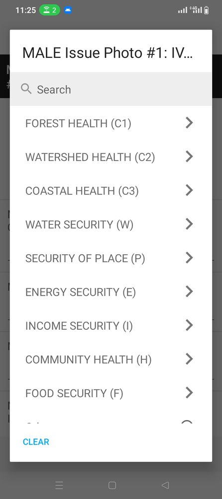

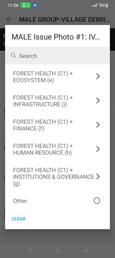

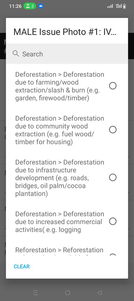

Hi,
I am creating a survey and would like to enquire about the possibility
of creating a cascading linked selection in a single question.  Something similar to the photos below.

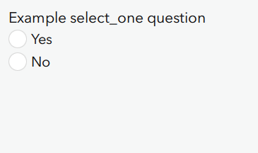

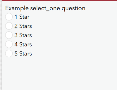

Cascading selects are a thing. And I guess you could add something to body::esri:visible to hide the previous question when a selection is made...
... but then you'd need to jump through some hoops to let users go "back" (I think JS may be the only way?) I lied. This is actually easy...
User selected "Clear Choices" and then "Show Choices" to reset the page. Works quite well actually.
