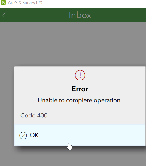

I am trying to create a link in the popup that opens a S123 Form... This is working for the most part but not for one Field...
I am querying the data to only place in the inbox if there are records there.  So if the permit number exists in the original data and exists in the form data it will populate those records in the INBOX and allow the user to update.
This works for a bunch of fields except the one I want... Its a string Field in both datasets with a length of 50.  I cant figure out why it works for some fields but not others.  I get the ERROR below
ANY THOUGHTS?

kapalczynski
OK I figured it out. but now dont know what to do...
The field in question is a permit number with this format..   xxx-xxxx
it appears the - is causing the issue... Anyway I can modify the query to not choke on the - dash in the field value?
