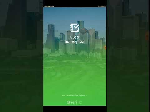

2. Inspired from this video (https://www.youtube.com/watch?v=gjBNJ-E21MY). Field staff opens survey123. They fill in the form and at some point I added a note with a link to Fieldmap for them to capture spatial information (e.g. point, polygon). They are then taken back to survey123 to submit their record. However it currently creates two points (one from fieldmap and one from survey123 with the data). It does not do at all like in the video. I used the following URL in survey123 but I feel like I am missing a point for the information not to pass onto the created point in fieldmap.
<a href= "https://fieldmaps.arcgis.app?itemID=93cbf3d1aff240a9a5a9314a35530739&referenceContext=addFeature&fea..., %22sat_name%22:%22${sat_name}%22, %22tree_sp%22:%22${tree_sp}%22, %22dbh_10%22:%22${dbh_10}%22, %22scat%22:%22${scat}%22, %22notes%22:%22${notes}%227D&callback=arcgis-survey123://">Open Field Maps</a>
