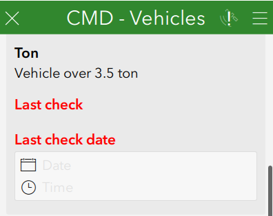

I've seen that the last_edited_date field doesn't work in Survey123. It returns an error when publishing a survey. However, I was wondering if there is a workaround. So, I created a new field that contains the date & time (it's been already populated). The problem is that I want to use this new field to show in the survey the date of the previous check done but the same field is going to be used to update the same date.

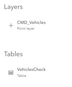

The field with the date is in the VehiclesCheck table. So I created another field in the main layer to copy the info of the date in VehiclesCheck to the new field.
I've already tried to use it but I get an empty result when using the survey.
