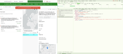

I have the same error "Item specified by surveyItemId does not exist or is not accessible" when I tried to manage a template to carry out a report.
The error affects only the last Feature layer (SURVEY123 form). The others still work.
SimoneLuppi
I fond out that in my case,
  • the issue is caused by using a select_one_from_file and the csv name contains brackets, e.g. “select_one_from_file italy_(2024)_specie_brc.csv”.
  • After publishing the survey (which works regularly), if I use  SURVEY123 connect v.3.22.49 (the last one) I was not able to open the Survey123 website successfully (see attached file), if I use SURVEY123 connect v.3.21.62 (the previous one) I can open the survey on Survey123 web app, but when I tried to apply a template to create a report, the web platform gives the error "Item specified by surveyItemId does not exist or is not accessible".
So, skipping brackets from the name of .CSV file, the error disappears.
