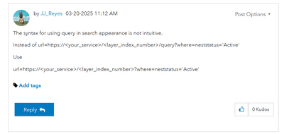

I am just going by this:
It seems querying directly from REST and in Survery123 have different syntax,  I just tried a where clause with 2 arguments with sample data and it worked in survey123 Connect.

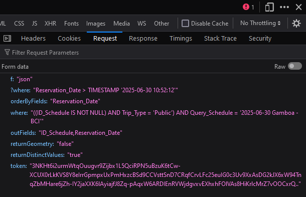

MiltonSolano
@Neal_t_k,
Thanks for the suggestion, but is not related to how to build the REST query. When the REST url is bad constructed, the search() ignores the query. See the next screenshot where I wrote the query url using your suggestion:
Just one "where" clause from the search() function. But if you build the query url properly, you get this:Screenshot 2025-06-30 10.52.20.png
Two "where" clauses: one from the query url and another one from the search() function. I don't know if this is expected behavior or a bug. The thing is the first "where" clause is ignored and not honored.

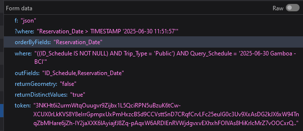

MiltonSolano
@Neal_t_k
Aaaaaarrgggg... I really hate when I think something is production-ready, and then—boom—turns out it’s not. Someone changed something that made it look like it was working… but it wasn’t.
Here’s what happened.
I initially changed the query URL from this:
/FeatureServer/0/query?where=", ${now_epoch2},"&orderByFields=Reservation_Date"
to this:
/FeatureServer/0?where=", ${now_epoch2},"&orderByFields=Reservation_Date"
It looked like it was working because someone had updated the schedule and results seemed correct. BUT… after inspecting the request being sent, I realized two separate queries were being executed. (See screenshot below.)

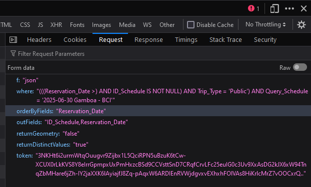

Following your advice, I replaced the first ? with an &, like this:
/FeatureServer/0&where=", ${now_epoch2},"&orderByFields=Reservation_Date"

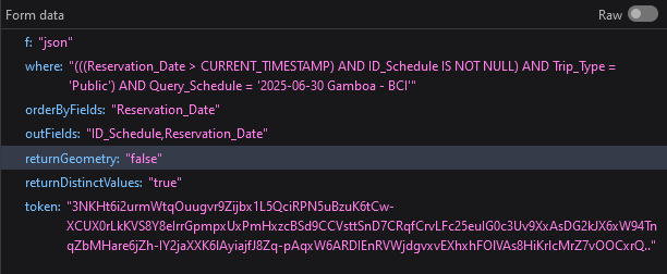

This time, the request sent only ONE query, with all conditions inside—finally the correct behavior. Still, I wasn't getting the expected filtered results. So I took it one step further and replaced the use of a calculated field with the SQL keyword directly. The final working URL became:
/FeatureServer/0?where=Reservation_Date > CURRENT_TIMESTAMP&orderByFields=Reservation_Date
(See screenshot for reference below.)
Now it’s correctly filtering the records on the WEB; on the app is returning the whole list with no filters. Thanks for letting me play forensic detective on this one!
