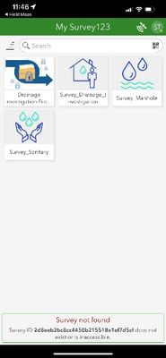

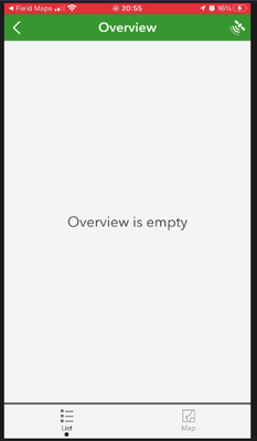

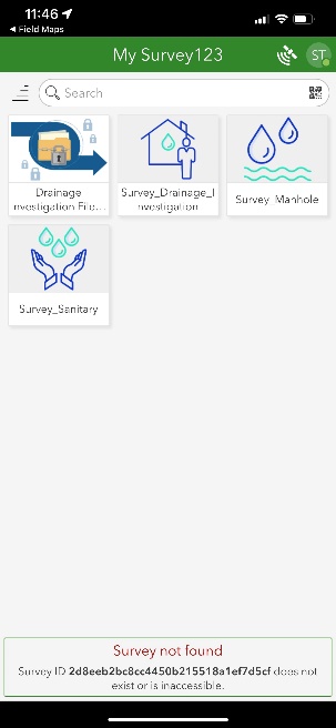

Everything was great until the update to 3.15.156.  Following the upgrade, the Field Maps component was ‘fine’ and would make the call to Survey123 in the same way, but depending upon the user the result would be either:
The second view says "survey not found", but it was confirmed that the surveyid number presented related to the survey_sanitary survey that was in the list above the error.
My client has the configurations for the above available in ArcGIS Enterprise (pre-prod and prod) and also ArcGIS Online.  Testing showed that the above error only occurred in the ArcGIS Enterprise environments.  Therefore, as their third-party support, I was called in to diagnose the ArcGIS Enterprise issues.

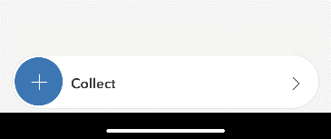

The survey had originally been configured so that a user could not ‘start’ the survey from Survey123.  The workflow ‘had’ to come from Field Maps.  For clarity, if the user opens Survey123 they would see the downloaded survey.  When they selected it, they would be presented with metadata of the survey, but the following button was not available and they could not open a form to complete the survey:
Once we had proven that ArcGIS Enterprise was not being called at that time, the client set about making changes in the way that Field Maps integrates with Survey123.

2)   In Survey123 Connect the options were changed to enable the “+ Collect >” button shown above.

The issue where the Overview folder is opened when Collect is disabled came from a change made to fix BUG-000148938 which went out with our 3.15 August update (3.15.156).
We have a fix for the Overview issue planned for our 3.15 September update which is anticipated to release in a couple of weeks.
