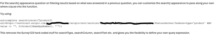

At the Dev Summit this week, all the Survey123 folks were super helpful. For this particular issue Zachary Sutherby ( @ZacharySutherby ) suggested the following which is working exactly as i needed (sorry for the screen shot but that's what i got for now).....

Hey @abureaux .
Thank you for your suggestion. That's a clever workaround that i think will get mostly what i was after.
