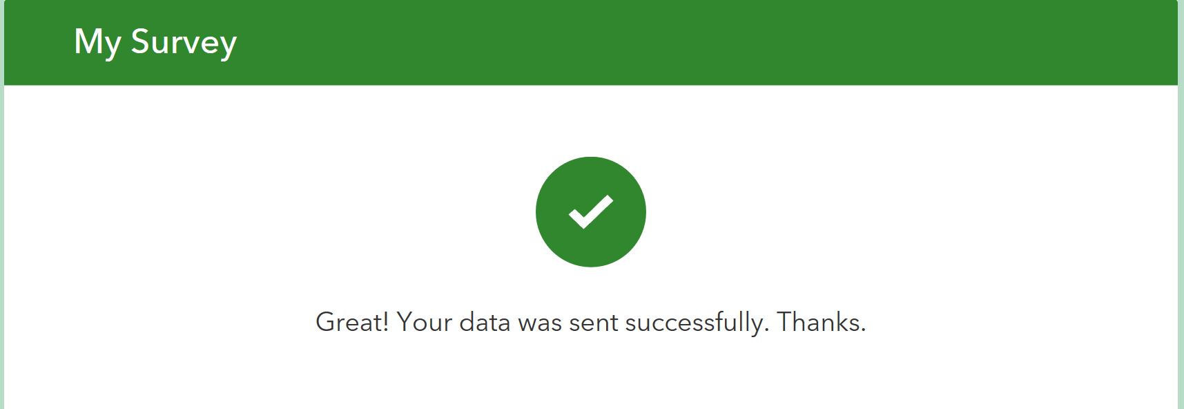

Hello, I am hoping to find out if there is a way to change the message the users get after they submit the survey form, or alternatively if there is a way to redirect the browser to another webpage after submission. The attached image shows what the submission message/page is by default.
This is the current page users see after submitting the form.
I would like to add links for takers to easily share the survey on social media platforms, via email, or the like. Alternatively, maybe there is a way to redirect the participants to my website which has information about the survey and research project directly after submission.
Any tips or information would be greatly appreciated.
I initially embedded links within the survey form, however it redirects using the same tab the survey is using rather than opening a new tab for the link. This does not seem like a good option rather a possible way to lose previously recorded data in the form.

Hi Kiley,
How did you publish the survey, via Connect or Web Designer? Currently in version 3.2 it is only possible to edit the Thank you screen message for surveys created in Web Designer, this is available on the Settings page when editing the survey design. You can add links to other website, images and other font formatting, all using the tool bar available in the edit window as below.
However, that being said, in the next release of Survey123 (due next week) version 3.3 will support editing the Thank you screen for surveys created from Connect. Please keep an eye out for this update if you are using Connect and want to edit this message:

The thank you screen is not set in Connect - go to the web designer page for the survey in the Survye123 website and you'll be able to set it there.
