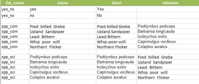

I have a question for a bird species common name. I want to populate the scientific name based on the common name. I have a choices table (image below). In my survey I have a question for common name which returns the spp_comm label. I want to have the spp_sci label returned in a subsequent question.
I was able to use the choice filter which returns a single choice but I would rather return a value than have to click a single choice.

Hi. At first sight, it looks to me like a good approach would be to use the pulldata function. To learn more about pulldata I recommend you read this blog post: https://community.esri.com/groups/survey123/blog/2016/10/27/the-pulldata-function-access-external-da...   Essentially, pulldata allows you to do a lookup table search so when someone selects a species by its common name, you can lookup the scientific name and display it in a Note or Text question.

RobCahalan
Thanks for the fast response Ismael! This works perfect!!
