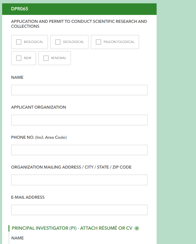

Obviously, applicants can open the link and see a page like this and complete the survey.

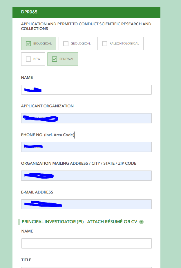

When a request is submitted, our staff need to open the request and edit it.
Now here is my question: Is there any way that we can create a link for ONLY THAT SCEPECIFIC submission to be edited so our staff would be able to edit the survey in a page like this:

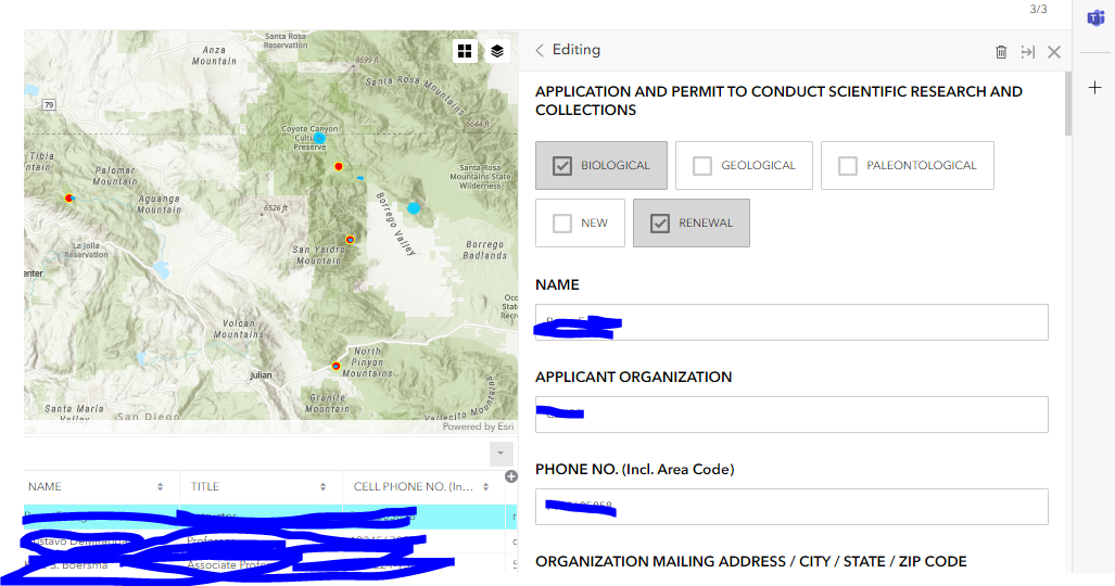

Instead of this?
