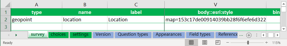

Hi. If using Survey123 Connect to publish your survey, you can apply the hide-input appearance to your geopoint question to make the XY coordinate user inputs read-only. https://doc.arcgis.com/en/survey123/desktop/create-surveys/xlsformsappearance.htm
Using Survey123 Connect you can also configure a custom web map  for your geopoint, geotrace and geoshape questions. All you need to do is to link your web map to your survey first, and then specify its item id in the body::esri:style column. Check this blog for details.  We are planning to add the ability to use custom web maps in designer soon. @ZhifangWang
