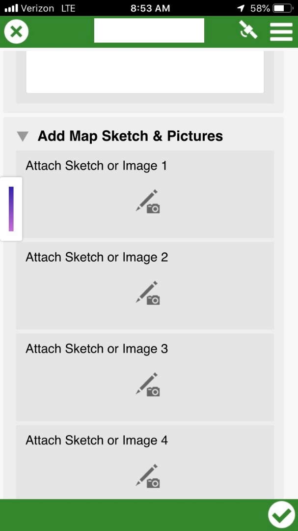

1. I fist have a survey with attachements, I then add attachment

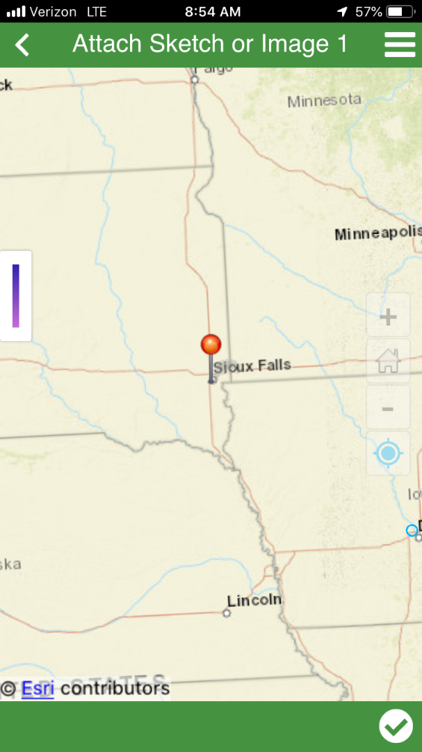

2. I then select the Map Icon and center my map where I want the snap shot to be taken, then click the check box

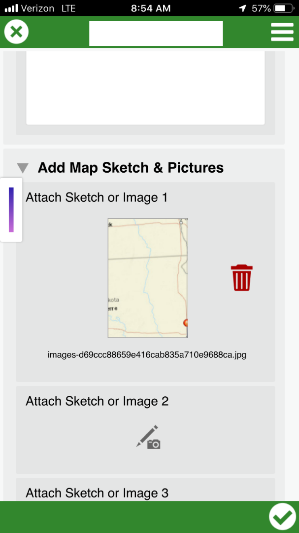

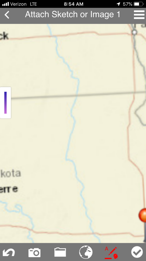

3. After i click the check box, the snap shot appears to only take a snap shot of the top left quadrant of the map?  This is only on IOS as i have confirmed the behavior does not happen on android,  Notice the pin below is in the lower right corner of the snap shot and not in the center?
4. The resulting attachment then looks the same

This also appears to happen for the camera and the photo selection option.  If you select a map/photo/take picture, in the new XFormSketchCapture it appears to only take the upper left of the picture/image.  Is this a know bug for this code?
MKa
I have figured out how to get this to work in IOS and had to comment out the lines of code XFormSketchCanvas.qml that specifically reference IOS.  Here are the 3 places I had to comment out the scaleFactor code to get the sketch to work on IOS.  Is this known?
