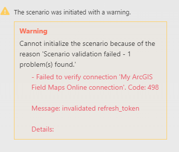

I have a webhook setup with Survey123 through Integromat that sends an email through gmail when a survey is submitted.  Today I started getting a warning:
  • Cannot initialize the scenario because of the reason 'Scenario validation failed - 1 problem(s) found.'
  • Failed to verify connection 'My ArcGIS Online connection'. [498] refresh_token expired
I'm hoping this is a simple refresh/re-path somewhere, but I'm not sure if it's on the Survey123 side or the Integromat side.  Any assistance is greatly appreciated.

I am still receiving this issue, two years later than your post:
