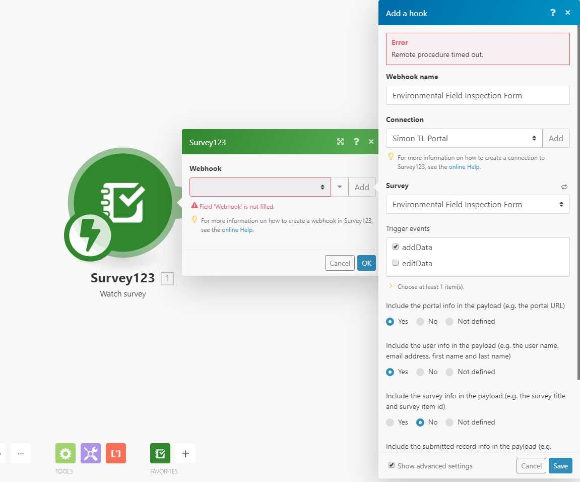

Hi,
I have started to have this issue since a few days back.
Whenever I try to create a new webhook on Survey123 (Enterprise), it comes back with an error saying "Remote procedure timed out"
It connects to the portal fine and the list of surveys pop up, but not succeeding at connecting to the survey.
It works for the other survey forms which already had a webhook set up from months ago but not for the new ones.
Integromat / Survey123 webhook creation error "remote procedure timed out"

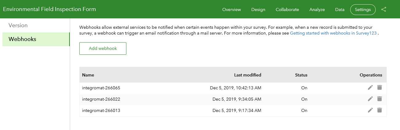

I checked the survey on survey123 website (Enterprise) and I could see that Integromat did succeed in creating webhook as pictured below but I cannot create/delete/edit it.
Survey123 Enterprise cannont create/delete/edit webhooks
Since the survey123 website is having troubles with creating/editing/deleting webhooks I feel like this is a Survey123 problem, not Integromat's???
I have tried republishing the survey with the newest version, recreating the survey completely, deleting/reconnecting to the portal, but none of these cracked it. So I am now completely lost here...

It appears that the issue is with Survey123's API attempt to add the webhook configuration; given that you actually see the configuration, the issue may be in getting a successful response from the ArcGIS Enterprise.  Could I ask that you file a support ticket to better diagnose this?
