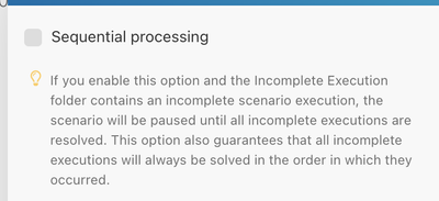

@YuliaMamonova Did you look at the advanced settings on your trigger module . There is a setting that allows you to specify submissions be processed individually. Would this help your situation.?
YuliaMamonova
Hi Paul,
Are you referring to sequential processing?
I have looked at it, and probably going to try it at some point, I can't activate it now, because I still have a huge amount of unresolved executions that I need to deal with.
