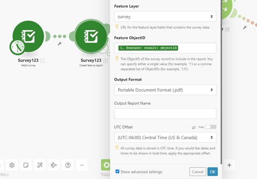

I'm getting a strange behavior with Integromat and wondering if I have a setting wrong somewhere that is causing my UTC Offset parameter to keep resetting to UTC -5?
Set correctly and hit save.Set correctly and hit save.Setting always defaults to UTC -5Setting always defaults to UTC -5
JamesTedrick
Esri Esteemed Contributor
Hi,
We've done some initial troubleshooting and think what may be happening is that the 2 entries of the list may have the same actual value (despite the label due DST differences in the Northern and Southern Hemispheres); when Integromat loads the value, it selects the first item loaded (bottom of the list) with that value.
JustinConnerWR
Appreciate you troubleshooting the issue. For now I've just manually entered the offset and set a reminder to manually change the setting in the spring.
