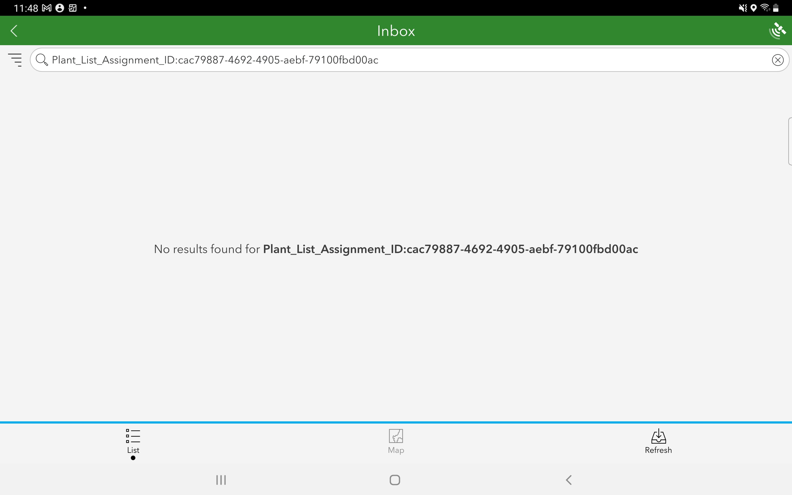

If I have the ability to reference a created unique id, what parameter key is best to identify and open the child survey? Filter and q:queryparameter seem the likely suspects, with filer perhaps preferred for offline use (?). Neither works in my testing. The q:queryparameter fails nicely enough in the intended survey inbox. Filter fails altogether with a survey not found error:

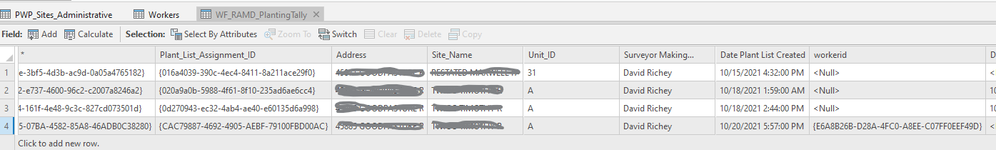

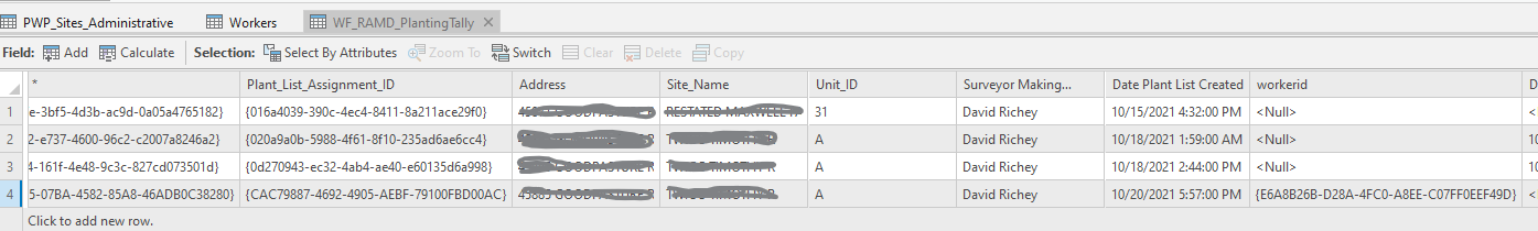

Here is the parent table from the child survey with the desired id link displayed.
I assume I am getting some element of the syntax wrong--or perhaps the feature does not work as intended.
