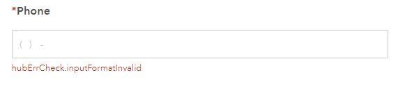

hubErrCheck.inputFormatInvalid is the error that displayed under the question for a phone number in the web form that uses an input mask. I added label::Español (es) to this question for Phone number. Switching between English or Spanish in the web form displays the same error. This error doesn't appear in the Field app.

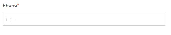

In a copy of this survey, that only uses English, this error does not display in the web form

After working with support, ESRI logged this as BUG-000144214, although I'm not finding it in the Technical Support KB.
My work around was to remove the input mask and show it as a hint.

This issue has been logged as  this salesforce issue and you may track the issue fix status using this number:
BUG-000144214 Setting an input mask in ArcGIS Survey123 Connect give error "hubErrCheck.inputFormatInvalid"
