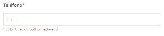

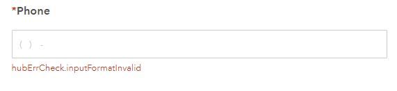

hubErrCheck.inputFormatInvalid is the error that displayed under the question for a phone number in the web form that uses an input mask. I added label::Español (es) to this question for Phone number. Switching between English or Spanish in the web form displays the same error. This error doesn't appear in the Field app.
