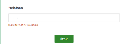

hubErrCheck.inputFormatInvalid is the error that displayed under the question for a phone number in the web form that uses an input mask. I added label::Español (es) to this question for Phone number. Switching between English or Spanish in the web form displays the same error. This error doesn't appear in the Field app.

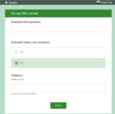

I can't seem to repro the issue you described. When changing the survey language to Spanish, I didn't see the error you pointed out.

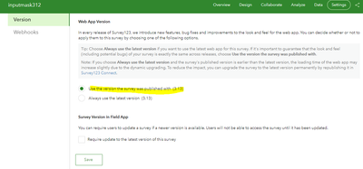

Could you double check the version setting in the web app to make sure the web app is using the version you publish from Connect?
MikeOnzay
It is the same version. I see the error regardless if I'm displaying English or Spanish. I will open a ticket with ESRI support

I was able to repro the error message only when there is no "label" column in the form. In both your and Mike's XLSForm, the default langauge was set to "label::English (en)" instead of "label" column. This results in the error message of "hubErrCheck.inputFormatInvalid" showing on the webform.
I will submit an internal issue for this but also encourage you to contact Support service to log a salesforce issue.
