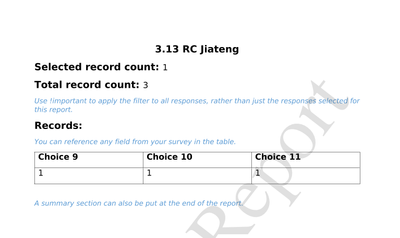

Here is my test survey, and I choose to print selected record only:
Here is my template:
Here is my final output, as you can see in the screenshot below, the !important override the selection:

The !important filter will only override what has been inherited from the data page (such as selection, 1000 limitation). If you put the !important at end of your where clause, it should work. e.g. ${Fire.. | where: "inspType=100 ... !important" | stats: "..."}
