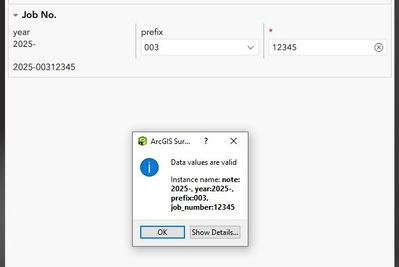

LaurenceTait
You need to use a regex. I've attached an example of that.
However...
I wouldn't do it quite that way.  Your number has two known, and largely invariant, portions. It is suboptimal to ask users to enter those portions manually. That in unnecessary work, it will increase the likelihood of errors, and also make it much harder to isolate where the error occurred.
What I would suggest is that you have the year hardwired, have a limited drop down for the first three digits, and only require the user to manually enter the last 5 digits.
With only 5 characters to enter, rather, than 13, you reduce the opportunity for error by ~60%.
