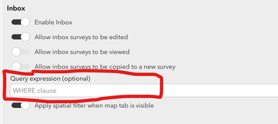

Once a survey is assigned to a person, meaning they are working on it.  You can put a query on to limit what is seen in the inbox.
something like:
<username_field> IS NULL OR <username_field> = ${username}
something like:
