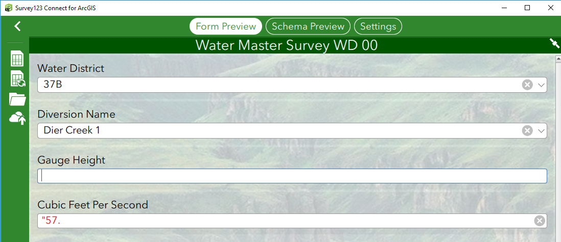

I am building a survey to record flow measurements for surface water. A user will read a staff gauge in a stream. This reading will then be entered into an equation specific to that stream to convert the reading into a flow expressed in cubic feet per second. I was hoping I could set this up as follows (but it doesn't work, but hopefully illustrates what I am trying to do):
The specific formula in the calculation field is thus pulled from a csv table called "RatingTableInfo" which looks as follows:
The results, when set up as shown above looks like this:
In other words, it just shows the first two numbers of the equation, rather than the result of the equation.  Is there a way to set this up so it actually does the math?

Hi Wilma,
After taking a look at the XLSForm and the CSV you provided, I think your best approach would be separate the calculation out from external CSV.  The idea would be to pull the unique rate formula from the CSV first, and then in a sequential question, reference it in a calculation that includes the formula resulting in Cubic Feet Per Second.
typenamelabelappearancedefaultcalculationchoice_filter
select_one WDNumberWaterDistrictWater Districtautocomplete37B
select_one_external DiversionNameDiversionNameDiversion NameautocompleteWaterDistrictNumber=${WaterDistrict}
decimalGaugeHeightGauge Height
calculatecalccalculation for pulldatapulldata('RatingTableInfo','RateFormula','DiversionName',${DiversionName})
decimalCFSCubic Feet Per Second(${calc}*pow(${GaugeHeight},1.6))
I have sent a revised version of the XLSForm and CSV in a reply to your email.
