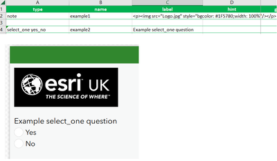

I would double check that you have included the correct image file format as it is case sensitive and ensure it is saved in the media folder. I used your code and mine displays as expected

Thanks for this.  Noticed you're using a jpg: are png's not to be used?  I tried your way and it still didn't work.
In the image I have attached, this works, however, I just wanted to use a header so as to not adjust the data model with a logo for each record.

PaulHallett1305
Hi Richard,
Note>logo>filename works
Note>example1>html doesn't work.
ideally, we'd like the html to be the one that works.
Cheers
Paul
