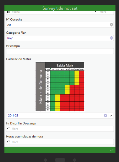

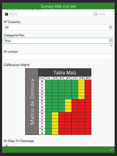

hi! i wonder if its possible to pre-select a Choise-One in a image-map using the calculate condition:
in my example its like this:
i whant to put any value... for example "20" in a integer field and after that i what to automatically be selected at the image-map choise:
i can bring the value... but when i made it using the iamge-map it seems to be not working well... here is the result:
and here its what it want to achive:

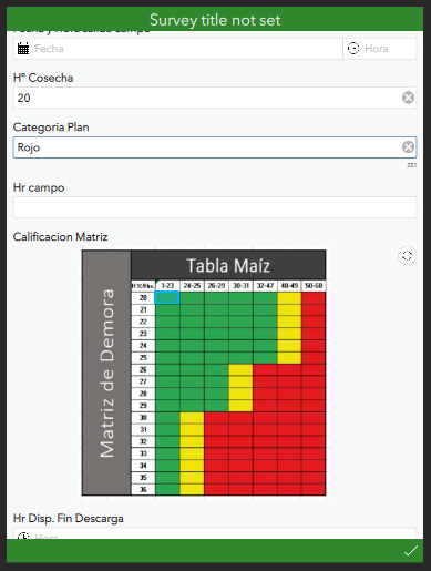

here its the code that im writeing in the Calculate field at the image-map choise: if((${h_cosecha} = 20   ) ,'20-1-23',0)
'20-1-23' its the awnser wanted at the choice sheet
i hope i made mysef clear... any questions im here
Federico
Jim-Moore
Hi Federico
The logic you're using should work; just to double-check, is "20-1-23" the name of the choice on the choices sheet, or the label? For the calculation to work it must be referencing the name of the choice, not the label.
