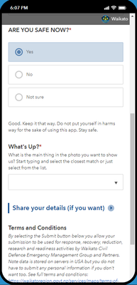

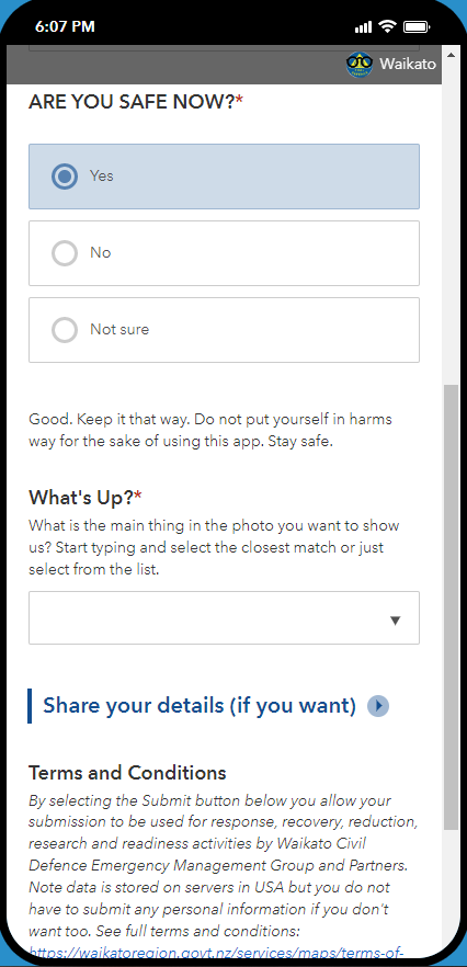

Is anybody else having issues with S123 3.17 web designed forms where Image and Audio question types (not sure about other Media and File question types) are not honoring rules from other questions that have been set for them? Here is my example...

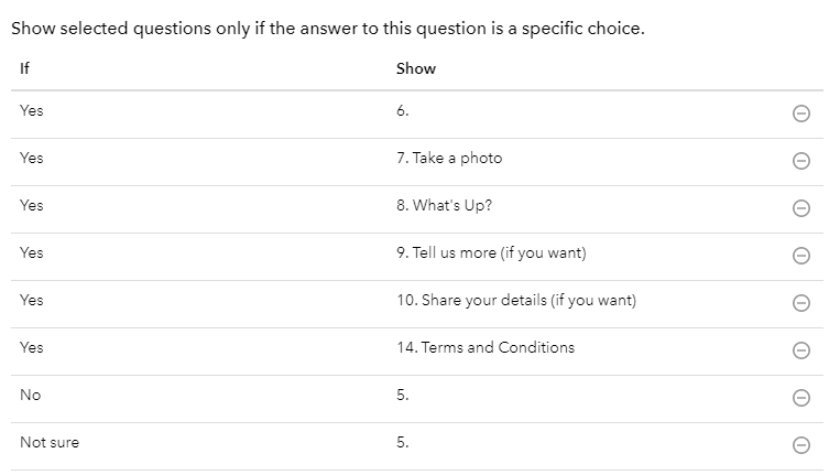

If a user answers a Select One type question in my survey then the following rules have been set for subsequent questions:
Q7. 'Take a Photo' and Q9. 'Tell us more (if you want)' are supposed to show if 'Yes' is selected, and while the other question types honor the rule, these two don't and remain hidden....
The issues occur both in the design preview and with the published survey on any device on any browser. This survey will not be used on the field app and it is intended to be public.
Is this another Set Rule bug or am I doing something wrong?

This issue came from our 3.17 April update that released earlier this week. The issue has been logged as BUG-000157639 and is planned to be addressed in a hotfix next week. The fix is currently available on https://survey123beta.arcgis.com.

The fix to this issue is available on the Survey123 website now. Thanks again for your feedback!
