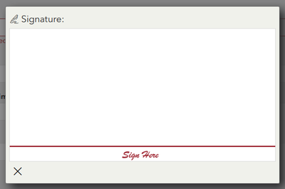

Fun tip for Signatures. You can add a default image to them as such:
This default image helps on two fronts I find: 1) "general" users that may not be as tech savvy have an easier time with the signatures, and 2) the signature size doesn't get all wonky due to screen size differences, making for a much prettier output.
