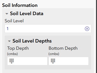

For context: I've developed a form where the user records different soil strata as they dig. The attributes of each of these strata (color, consistency, observations, etc.) are recorded in a ${SoilLevel} repeat. The user records the top and bottom depth of each of these strata (see below).
I'd like the form to fill in each level's Top Depth (${SoilTopDepth}) automatically with "0" for the first level (${LevelNumber}) and the previous level's Bottom Depth (${SoilBotDepth}) for all levels after that.

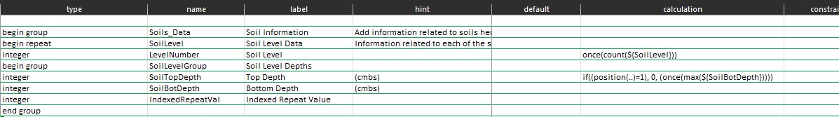

The formula I'm using in the ${SoilTopDepth} field's "Calculation" column isn't populating the field on the form:
if((position(..)=1), 0, (once(max(${SoilBotDepth}))))
For broader context, here's a screencap of the relevant section of the XLSForm:
Can someone point out what I might have wrong?

archeomason
Thank you very much, @DougBrowning! I will try that out. And I just may take you up on your offer!
archeomason
That worked like a champ! Thank you very much.
For what it's worth, I did have it working using the indexed-repeat() function, where it would populate from the previous record's (position(..)-1) bottom depth, but I had this warning prompt saying I had a circular reference that might cause errors in calculations. So I was trying to find a better option.
Yours seems to work great. Thank you very much, sir.
